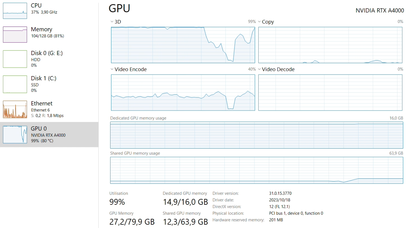

I've been doing some testing with Karma XPU and most of the time the RAM usage is manageable however sometimes the memory usage spikes so high on both system and VRAM. It causes Optix fail and the GPU not to render at all I suspect.
Feels like some kind of memory leak or something in the scene misbehaving with Karma specifically.
Rendering the same scene in either Arnold or Redshift yields lower memory usage.
Karma XPU:
The logs only eventually say:
KarmaXPU: device Type:Optix ID:0 has registered a critical error , so will now stop functioning. Future error messages will be suppressed
The render does start and complete on the CPU.
Example of Arnold GPU memory usage on the same scene. (Shaders, mesh properties, render settings, amount of AOV, etc. matched as best possible)
So we're getting a "74 GB" difference in system memory usage, which is quite significant.

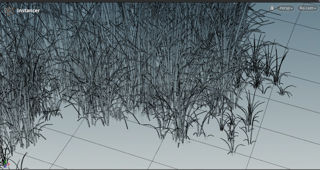

There is alot of instanced grass geo, which in Arnold for example has x1 Subdiv iteration.
For Karma, I gave it the catmullClark subdiv scheme and lowered the dicing quality to 0.01 to hopefully optimize it.
What is the geo? curves?
There is a curve memory/speed optimization for curve GPU memory that might help.
KARMA_XPU_OPTIX_CURVE_OPT_LEVEL=1
https://www.sidefx.com/docs/houdini/solaris/karma_xpu.html#features [www.sidefx.com]

The grass is geometry based "tufts" which is instanced to points via an "instancer" they are quite low poly.
We opted to go with geometry because it's both lighter in the viewport and gives a little more control
