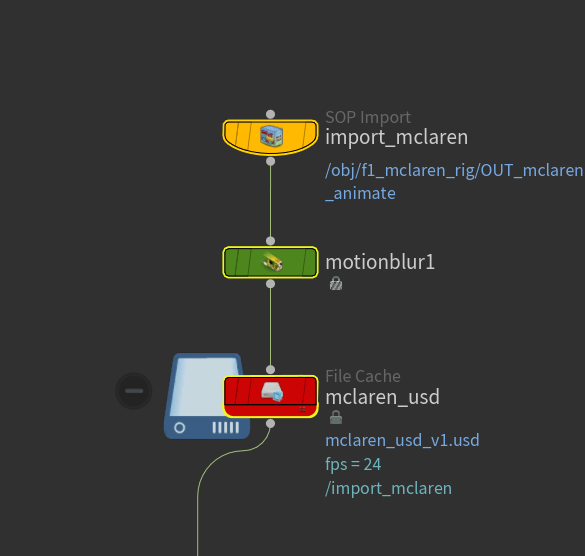

Greetings,
I'm having some issues with motion blur in karma when rendering some car wheels that are outputted from an rbd car path follow sop exported to USDsd using USD export.
My camera is derived from the camera export option from the RBD car rig setup and tracks the car in motion. The camera data is coming from obj context and is imported to LOPs via SOP import then cached. The object blur itself looks to be accurate, but the size of the wheels dramatically fluctuates frame to frame as the camera shutter time increases.
I've tried a few approaches trying to pinpoint the issue including different motion blur/caching solutions as well as packed primitives vs. raw mesh transforms.
I feel like this is something that would be pretty obvious, so I'm inclined to believe I'm doing something wrong.
Any ideas?
cheers~

Here is a condensed scene of the issue I'm still seeing.
There is a small usd export and a small camera cache that needs to be saved to see the issue.
Seems like something is happening in the rbd path follow that is affecting the moblur in solaris to cause the shrinking.
I've run a couple tests just using regular transforms for rotations in mesh and packed primitives and those seem to work fine.
Any insight would be appreciated.

Ok, thanks to Jim et.al, I have this working.
It really was just an adjustment on the moblur samples in LOPs. I didn't realize you could stack the LOPs moblur on top of the cache and keep the cache samples, and moblur karma render settings set to default.
Probably obvious to everyone else but if this helps anyone...
