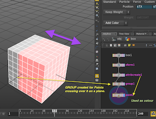

Yes! You might say that could be a missing link in your thinking of AttributeCreate!
5 is an arbitrary figure with no purpose. Why did you make it 5?
Think of it as AtrributeCreate With Purpose!
In the attached file the box is animating, a group node groups points crossing over value 0 and then the pointcolour uses the value of the attribute create to colour those grouped points.
It would also be good if others could supply different examples too. Many ideas are good to learn from. Thanks!
Edited by - April 3, 2014 21:22:03

ForeachSOP allows you to execute an action on each part of a geometry based on some criteria. In that case, it simply deletes all primitives with the attribute value other than currently proceeded. In plain English: for every distinct attribute value do something - but only with the part of a geometry, that holds that value.
So the geometry does indeed gets stored with the values?
SYmekHow do I know that this node is so intelligent? This behaviour is not documented in the help, that leaves me guessing what a node is capable to do.
This is exactly the reason why primnum was created: to allow selecting subdivided geometry based on it's pre-subdivided primitives numbers. SubdivideSOP intelligently assigns to new polygons its parent's attributes values.

Because you put frame() into numeric parameter, where things are simple: anything which is not a number is an expression.
Contrary to this you use $OS in string parameter, so Houdini can't know if a string you have just typed has to be treated literally or as an expression to evaluate. $OS isn't expression per se, if it was, you would have to use back-tick to evaluate it like: `expression()`.
$ at the front of $OS says: I'm a local/global variable, not a string. Type \$OS to turn it into a string and see how Houdini doesn't know what to do with that.
The problem is that back-ticks don't work with Python, that's why set keyframe is used instead as I suppose.
Sorry I didn't get that?
If you apply a varying color to a mesh and start changing topology by inserting new primitives (polygons), they usually get color from neighboring polys, right? In any software there is… This is the same behavior. Houdini is very consistent in that manner. It inherits or interpolates any attribute present on a geometry. At least it never deletes anything.
