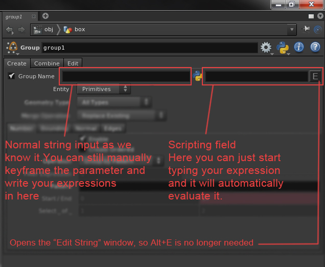

Ok, then no leading underscore but some other simple prefix to have easy equivalents. I'm just looking for something like
$OS = prefixos()
$TX = prefixtx()
$PR = prefixpr()
pezetko
Just learn, that if you want to write expression put there keyframe first than write expression into that field, that is universal (across hscript and python).
Yes it is universal but neither necessary nor efficient. The question is: Should it be universal throughout HScript and Python? No.
My attatchments show that it is easily improvable and still optional so you can keep your habits but others have the option to choose an alternative.
pezetko
Extended expression editor (Alt+E) is handy if you write longer expression or want to debug it.
Yes, that's why I want there to be a button within close reach.

ps o I don't see the rationale for making double parameters window. One of the greatest advantages of Houdini interface is the you can put expression almost everywhere. Making twice as many parms as now, half of them with seriously jeopardized usability sounds strange to me. What I do like is that any parameter clearly indicates its state.
What I actually meant was to introduce this double parameter for string parameters, like group name and such. Since numerical parameters recognise expressions automatically it's not needed there but for string parameters that, as you said, can't distinuish between expression and normal string input it makes sense to have a field where you can type in a string and one field that is especially for expressions. This way the user doesn't have to take are about what state a parameter is at the moment and to set a keyframe each time.
