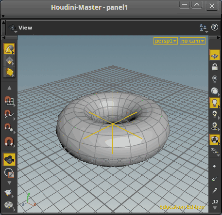

Hi there,
Just wondering if anyone could help me here, I'm just trying to constrain a null to a point in my scene.
Thanks,
Pete
