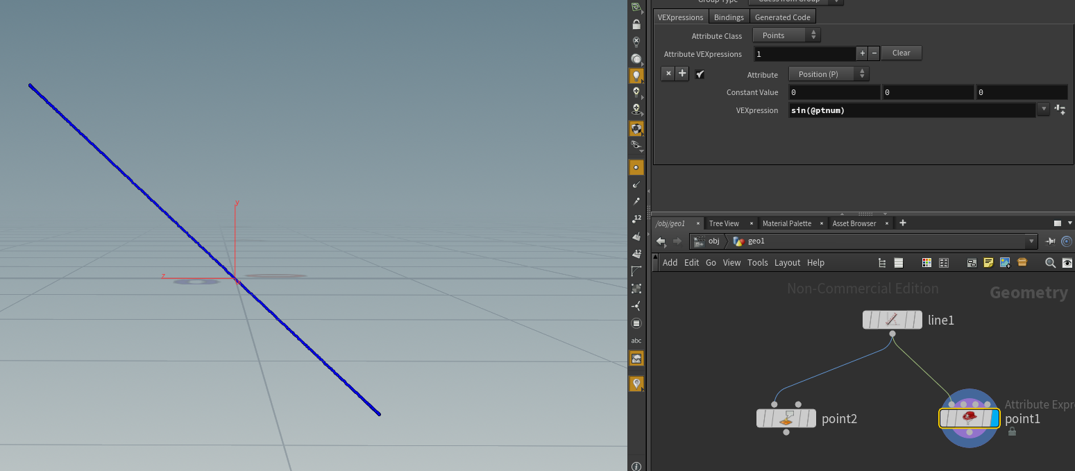

Hello, In the Old point SOP you could do sin($PT) to get the sin location for every point on just the Y value.
What is the equivalent in the new Point SOP. I'm not finding a way to isolate just the Y value.
Also is the Vector attribute class now gone in the new Point SOP?
Thanks!
Trying to replicate the picture below using the new method
Old vs. New Point SOP

Another approach is to do:
Then change the “Constant Value” from the default 0, 0, 0 to 0, 1, 0. The constant value is available as value. This then lets you control which axis you apply the sine to without having to edit your expression.
Going a bit farther down the rabbit hole,
After putting that in the VEXpression, press the slider button. You'll see two new parameters appear, Period and Amplitude. Change them to 1, then you can adjust your sine behaviour without typing.
self + value * sin(radians(@ptnum))
self + value * sin(radians(@ptnum) / ch('period')) * ch('amplitude')

In the old Point SOP, we could simply put sin(@ptnum) in the PY parameter field. I believe this is a much simpler approach for beginners to get used to expressions and the concept of variables and attributes. Also the old Point SOP had relevant @attributes placed in the parameter fields. This was a great way for new users to see: oh: @P.x, @P.y, @P.z is how you would access the different components of the Position. Or @N.x, @N.y, @N.z for Normals.
If the default is now:
Set Constant Value to: 0, 1, 0
Set VEXpression to: self + value * sin(radians(@ptnum))
That's a lot of additional work - and possible “human error”, just to get a sine wave.
It's beginning to feel much more verbose. It also doesn't have any visual clues as to how you might want to reference a particular attribute (such as position). While, yes, you see Position(P) in the drop-down menu, it doesn't visually show it being used like: @P.x, @P.y. @P.z
While, this workflow is probably fine for older, more seasoned users, who are used to typing expressions, referencing attributes, using variables - newer users - (In my opinion) are not going to find this as simple.
Possible solution:
What if the Attribute Expression SOP included a “self” field - vector or scalar, depending on the attribute. In the fields, are the relevant references - @P.x, @P.y, @P.z for Position for example. This would kind of mimic the “old” Point SOP in that specific respect.
This will have two benefits: 1) Newer users will get some visual reference as to “how” to go about accessing specific attributes. 2) Less verbose - we could just set the self.y field to sin(radians(@ptnum) and call it a day.
Thoughts?

While I sympathize with the simplicity of just changing Y; by far the most common complaint/refrain about the old Point SOP was that you had to type everything thrice. Any non-trivial expression is always cut & paste and slightly modified to make three copies….
Even the case of adding a Y-sine wave is probably best expressed in terms of 3 space rather than adjusting Y. This preempts the question of “How do I do this about another direction than one of the primary…”
So I'd personally rather the default Attribute for P be “@P”.
The problem then arises: what happens when you change that attribute menu? Do we replace the vexpression with the new value? But then it is hard to change an attribute after the fact, such as when you've built something for Cd and then decide you want to manipulate your own custom attribute instead….
It is rather annoying trying to set just a single component, however.
Maybe have a component mode that instead gives you three vexpressions that default to self.x, self.y, and self.z?
Cause I do agree using set() is very esoteric. Will be tricky to find where to put that toggle without further cluttering things… I really would like this UI to be as streamlined as possible for simple things. It already has too much chrome.
