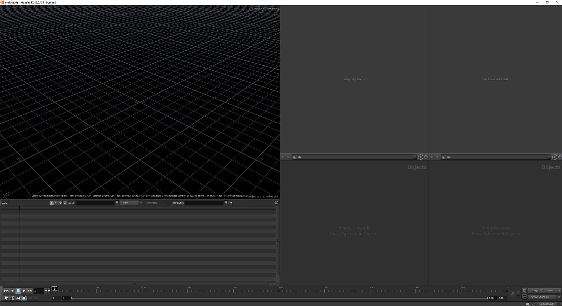

You could enable Toggle Stowbars for the entire screen or certain windows. This helps with hiding elements of a UI or the entire UI. It makes life easier when you are on a laptop. You can also set it to a hotkey. You could also customize your UI to fit your needs.

Stowing bars is very useful as well as getting rid of a lot of large UI items like shelves. It can make a massive difference on laptops. If I need to invoke a shelf tool, it's easy to do so using the viewport TAB menu. So I lose nothing but gain a lot of screen estate.
