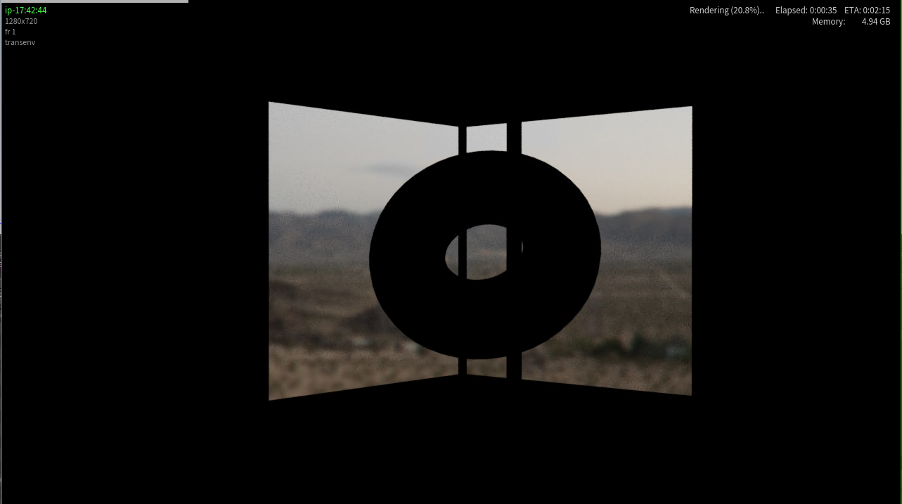

Experimenting with this a little further, I feel like I am missing a step somewhere.
I have set up two Karma outputs, the first produces a beauty pass with the HDRI set to be hidden from camera & refraction rays:
Edit: I had the wrong image here when I initially posted -- it has been updated.
The second output disables the Dome Light & places a background plane behind the scene with a ST map projected from the camera to a surface shader. All but the refract component is disabled on the rendersettings prim, and this is the result:

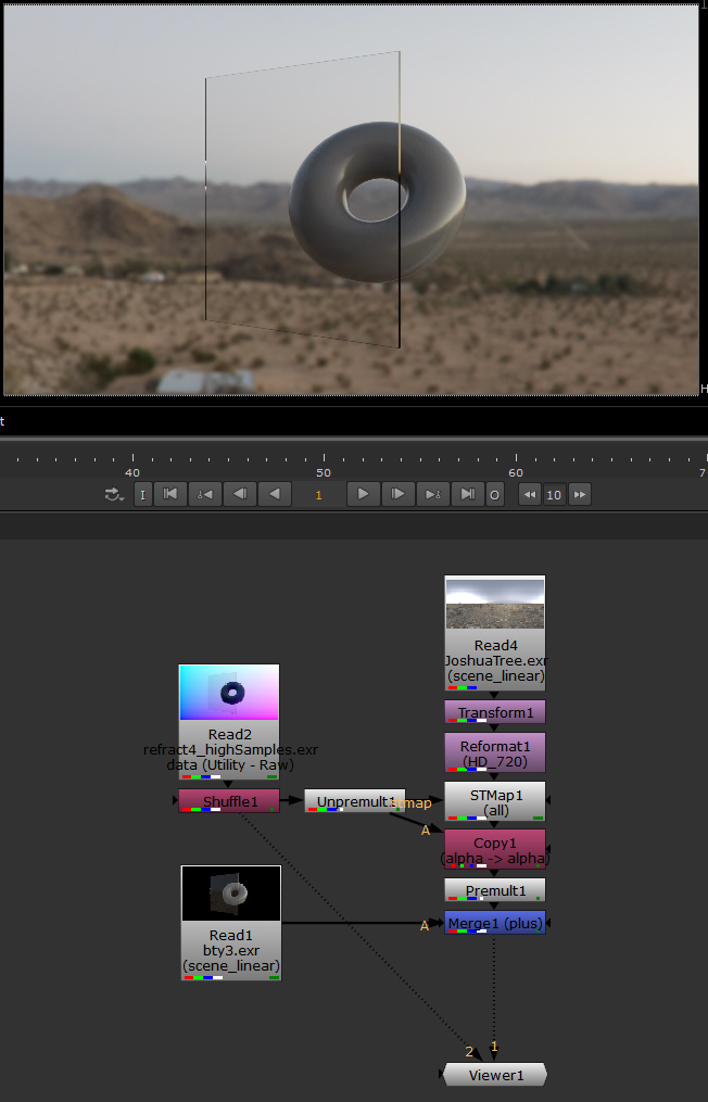

In Nuke I'm using the same image HDRI in the background to make comparison easier, and there are two obvious problems:
First: compared to the in-engine render of the Dome Light through the glass, the refraction is significantly deflecting the angle of the light. This is probably caused by what appears to be a drop in values for areas seen through the glass. I'm not sure why this is, as the glass shader does not have absorption or roughness.
Second: because black is a valid coordinate on an st map, we get whatever color happens to be in the bottom-left corner of the source image mapped to any dark areas in the refraction pass render, which leads to the plus operation adding value to areas on the torus that should not be affected by refraction.

this is where the mask AOV propagation through refractions would have helped as then you could have both mask and uv refracted in the single pass so that you'd have contribution
now you mau need to do another render of just refracted white dome to get the contribution that will act like Alpha for stmap, so that you can unpremultiply it to cleaner values for mapping
and then scale back down before adding the rest

if you put solid color in the blue channel of the st map, you can skip having to do a separate render.
Joined: 2月 2017
jsmack
Aha, I was wondering if there was a way to use the blue channel to do masking somehow. That worked for me, and the resulting comp looked similar to the in-engine render with the Dome Light as a background:
I noticed that when switching the comp background to something with more pronounced HDR values that I was getting a *lot* of noise though, even when I cranked the samples way up on the refraction pass render:
It looked like there was something up with the refraction pass itself -- bumping up the viewer exposure I could see there was a lot of noisy information in the R & G channels on the torus that (as far as I understand) should not have been included in the render with the components set only to "refract":
Am I misunderstanding the effect of setting the export components like that? It feels like it's somehow still including a reflect component.
As a test I made my own "refract" AOV with a simple LPE and a custom tag on the st map material: C.*T'stmap', based on the idea that I want to record *only* the rays exiting a transmission event and striking the background.
Using my custom LPE AOV for the refraction pass I get a much cleaner result that doesn't affect the torus at all, it only distorts the background plate as expected:
I'm not that knowledgeable about LPEs or the Karma AOV workflow though -- are there conditions I'm not considering here? Was there a better way to set up this refract only AOV?

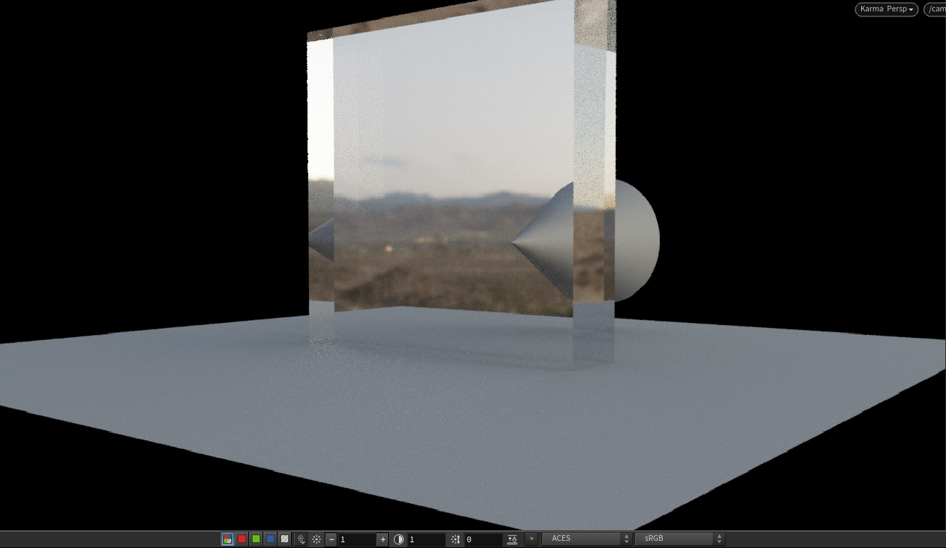

Taking the difficulty up a notch, I'm trying to work this now with multiple transmissive planes -- like a car with an interior. This is a Karma reference render with all Dome Light contributions enabled:
It looks like the -refract setting on the Dome Light for Karma results in preventing illumination from entering the interior of the glass box even for the purpose of other glossy scattering events. This behavior is different from the equivalent settings in Arnold, which only removes the final transmission-->light event (Karma on the left, Arnold on the right):
So now it is necessary to create all that illumination in comp -- and the results are problematic in terms of both noise and the artifacts from internally reflected rays having nothing meaningful to sample from the st map:
This is a place where I feel the Arnold setup is just more practical. I understand it's not optically correct, but having those options is not preventing you from doing it the right way on hero elements, and having to work out a comp solution for this kind of transmission scenario isn't an appealing prospect for day-to-day renders of non-hero elements...
Maybe there's something else I'm missing though? Like is there an alternative to setting the Dome Light contributions to -refract to get it out of the beauty pass?
Edited by jedmitchell - 2023年2月5日 14:28:18
Joined: 2月 2017
Playing around some more I found a solution that almost works -- instead of disabling the refracted light in the beauty pass, I've left the background in the beauty and then done a subtractive comp operation with a custom LPE that only contains Camera-->Transmission-->Light events with a tag like CT+'env'(the 'env' tag is on the Dome Light):
I still need the mask generated by the blue channel of the refract pass, but I can modify it to correctly represent the transmission-only path and then subtract the Dome Light background from the beauty. Basically it works:
The results are still very noisy though (this is after the minus operation):
I was able to get the noise down to a reasonable level but only by massively oversampling:
Denoising helps in some areas but introduces more artifacts elsewhere, as usual -- and generally we can't denoise sequences anyway. Are there any other tricks I'm not thinking of here? I'm sure I could optimize the sampling settings to some extent but the jump in render time to get a clean comp was so great that it makes this approach basically unworkable for us.
