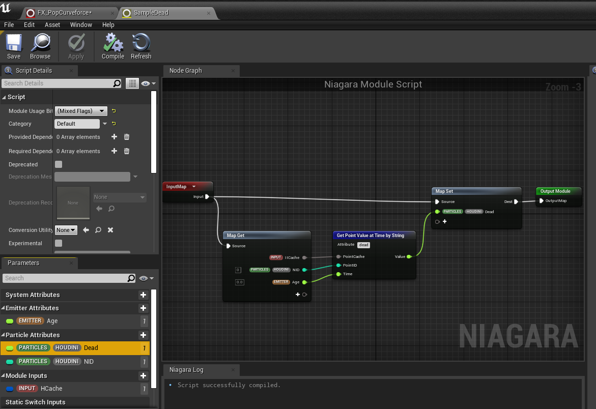

Joined: Jan. 2018
Hi Mike, thanks for creating the Lab tools and this kind of workflow for Houdini and UE4. Really appreciate the efforts.
I was going through the news videos you posted. Everything is working fine except for the custom attribute thing. Whenever I am adding the custom attribute module to the Particle Update, it is throwing compile error. In the log, it is saying “Cannot access field ‘HOUDINI’ of structure” and “cannot assign value of type ‘float’ to type '': no implicit conversion allowed”.
Any idea why this is happening?

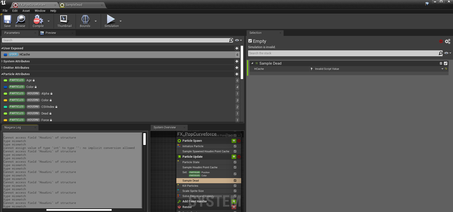

Joined: April 2014
Are there any learning material/demo scenes for the creation of crowds using Houdini to Niagra?
I can't get the same result as the video.
The engine version is 4.25.
Is this a bug? Is it my mistake?
And there is a mysterious lock mark.
394 posts
Joined: May 2017
I think the mistake is that you're trying to set the houdini.particle.position instead of particle.position. Just below SampleSpawnedHoudiniPointCache.
Have you downloaded the content plugin in the first post of this thread?
Thank you for your reply.
Thank you for the appropriate point.
Yes, I downloaded the plugin here.
It went well
Edited by Yoriyiya - May 20, 2020 14:21:01
I had the same problem.
